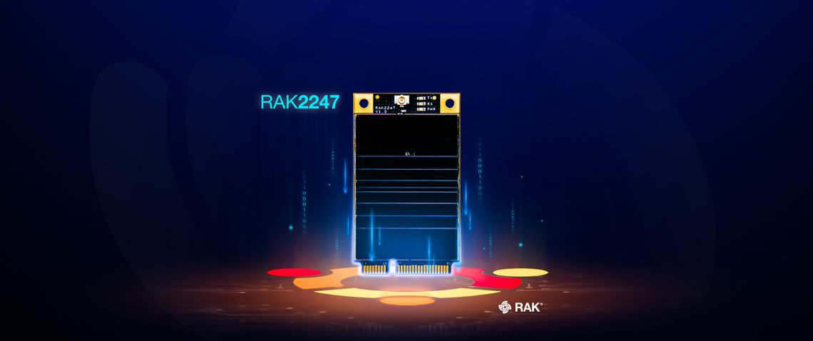

As a result, numerous IoT devices, from LoRaWAN® gateways to LoRAWAN modules, are now capable of being configured with a Linux machine – an example of which is the RAK2247 LPWAN Gateway Concentrator Module from RAKwireless. This 8-channel LPWAN module supports the LoRaWAN 1.0.2 protocol and is equipped with a mini-PCIe form factor based on the SX1301 chip from Semtech. If you’re curious as to how you can unlock the Linux capability for your IoT device, then continue on reading our tutorial with the RAK2247 concentrator module.
The RAK2247 is the evolution of RAK833. It retains the same small form factor (mPCIE) and is just as easy to integrate as the previous model.
