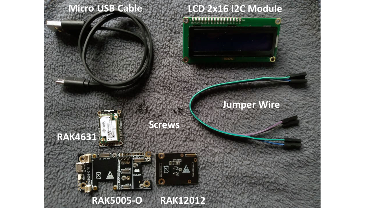

Here are the parts and materials you need in creating your Pulse Oximeter Sensor with WisBlock:
- RAK5005-O WisBlock Base Board
- RAK4631 WisBlock Module for LoRaWAN
- RAK12012 WisBlock Heart Rate Sensor Module
- Alphanumeric LCD with I2C interface
- Jumper Wire Female to Male
- Micro USB cable
- 2.54mm Single Row Male Header Connector 4pins
- 2.54mm Single Row Female Header Jumper Cable 4pins
- Screws
- Arduino IDE

- Gather the following parts and materials below in creating the Pulse Oximeter Sensor using WisBlock

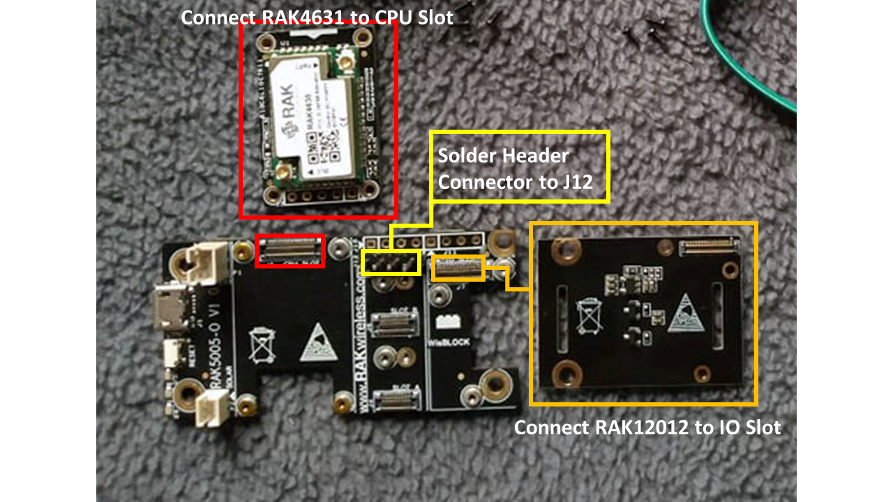

- Connect the RAK4631 to the CPU slot and solder a 4pin female header connector to J12 then attach the RAK12012 to IO Slot.

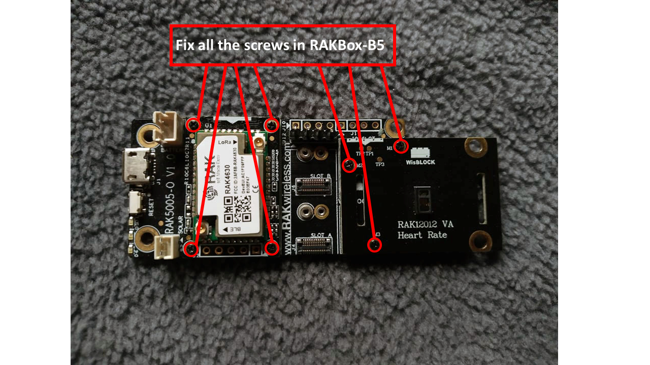

- Fix all screws in the RAK5005-O for a secured connection
