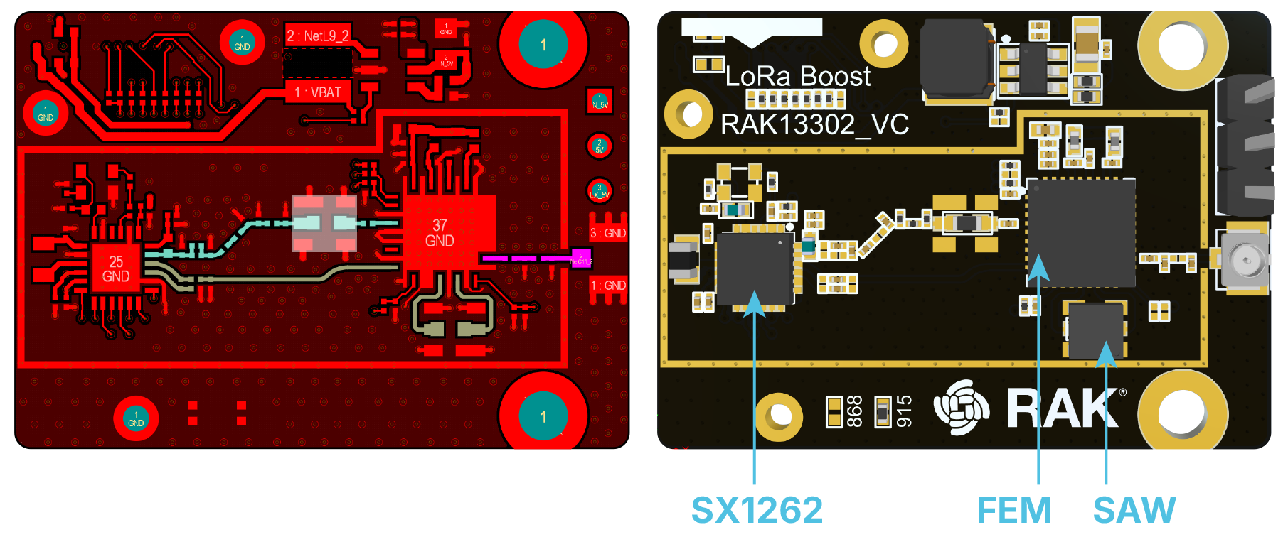

Most DIY 1 watt boosters and PA-only modules improve only the transmit side. This allows the node to shout louder, but it does nothing to improve its ability to hear replies. The result is a classic RF failure mode where a node can reach a distant device but cannot receive its response. This leads to broken links, unidirectional communication, unstable mesh behavior, and the illusion of long-range performance without the reliability that a true mesh network requires.
A real 1-watt LoRa RF chain showing SX1262, FEM, and SAW filtering that prevents the TX-only imbalance common in DIY boosters.
Effective long-distance communication requires a balanced link budget. Transmit power must increase alongside receiver sensitivity; otherwise, the system becomes lopsided. Boosting only the transmit power is like adding a megaphone while wearing earplugs. It looks impressive on paper but fails in real-world conditions where reliable two-way packet exchange is essential.
Why Filtering Matters
Power amplifiers introduce harmonics, noise, and spurious emissions that can degrade or even overwhelm the receiver front end. Without a proper band-pass RF filter, these unwanted byproducts pollute the signal chain. The receiver becomes less sensitive, more easily overloaded, and worse at hearing weak LoRa packets. This is why many community-built PA-only setups perform worse in practice than expected, even though the transmit number looks higher.
The Role of a Dedicated RF Filter Stage
A real 1 watt LoRa radio must include three specialized components working together:
  • A power amplifier to boost transmit strength
  • A low-noise amplifier to enhance receive sensitivity
  • A band-pass RF filter to remove noise and protect the radio chain
The RF filter is the key to stability and compliance. It cleans the transmitted signal, protects the receiver from overload, and ensures the device meets regional emissions requirements. With proper filtering, the system delivers a true long-range bidirectional link. Without it, the radio becomes unstable at high power levels and cannot achieve reliable performance.

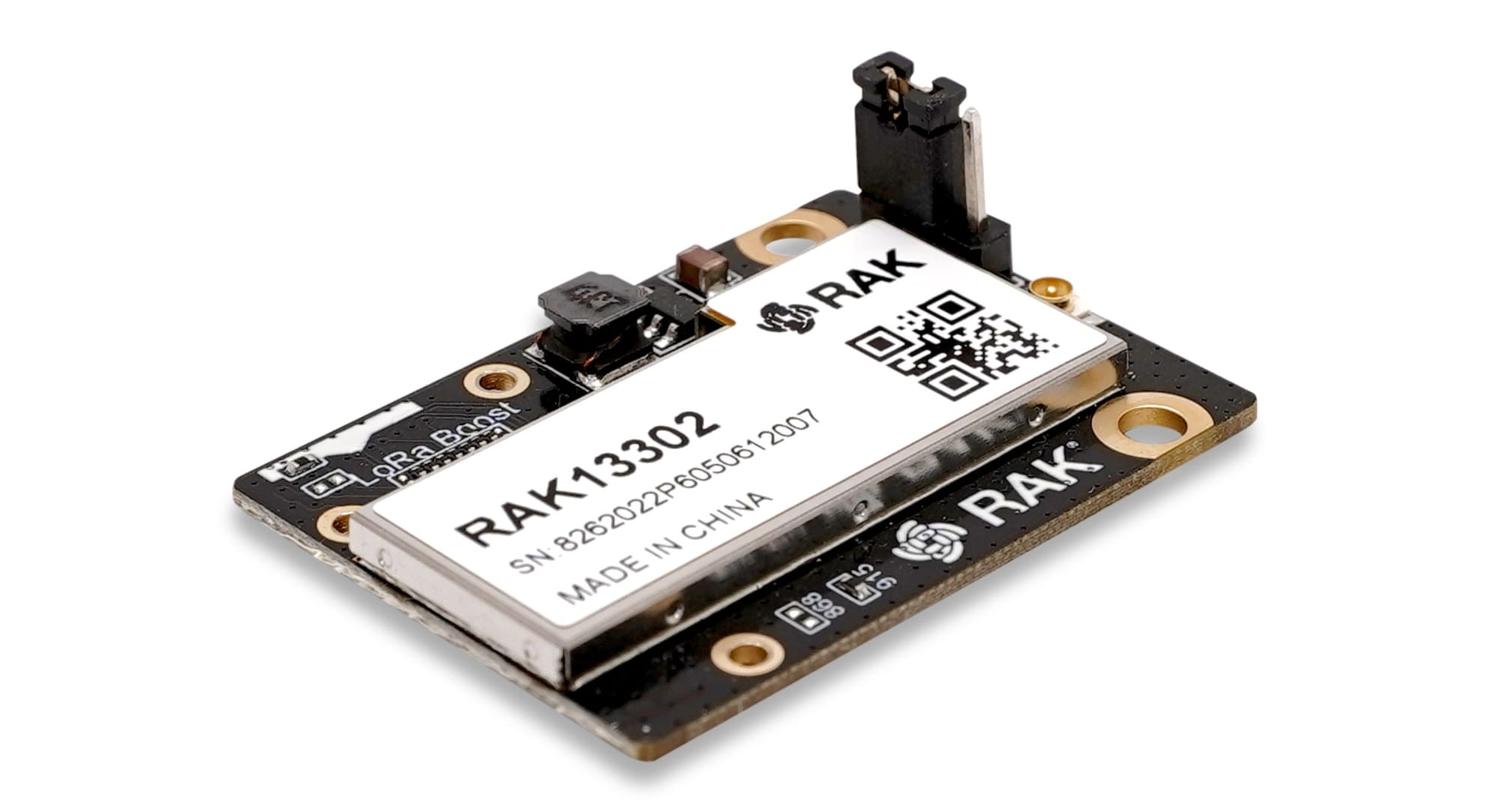

Why the RAK13302 Architecture Works So Well
At this point, it becomes clear why simply adding more transmit power is not enough. To create a true 1 watt LoRa solution that actually improves both range and reliability, the hardware must be engineered as a complete RF system. This is exactly why the WisMesh 1W Booster Starter Kit exists, and why its core module, the RAK13302, is central to the entire design.
RAK13302 module shown as the core engineered RF system enabling clean, stable, compliant 1-watt LoRa performance.
The RAK13302 brings together three critical components that allow high-power operation without sacrificing receive sensitivity or stability:
  • The Semtech SX1262 LoRa transceiver
  • The SKY66122 front-end module with PA and LNA
  • A carefully tuned band-pass RF filter
These pieces are not simply stacked together. They are engineered to work as a cohesive signal chain that stays clean, stable, and compliant at 1 watt output.
The Architecture Behind a True 1-Watt System
The SX1262 provides the high sensitivity needed for long-range LoRa, ensuring the radio can still hear weak signals even during high-power transmission. The SKY66122 adds efficient amplification and an integrated LNA, strengthening both transmit and receive paths. A dedicated RF filter keeps the system clean, protecting the receiver and maintaining regulatory compliance at 30 dBm.
Together, these elements create a balanced, reliable 1-watt design that offers:
  • Stronger links in both directions
  • Improved sensitivity in noisy or obstructed areas
  • More stable mesh behavior
  • Fewer retries and dropped packets
  • Clean spectral output that meets emissions requirements
This engineered combination is what makes the RAK13302 the foundation of the WisMesh 1W Booster Starter Kit—delivering real 1-watt performance without the compromises of PA-only or DIY booster setups.

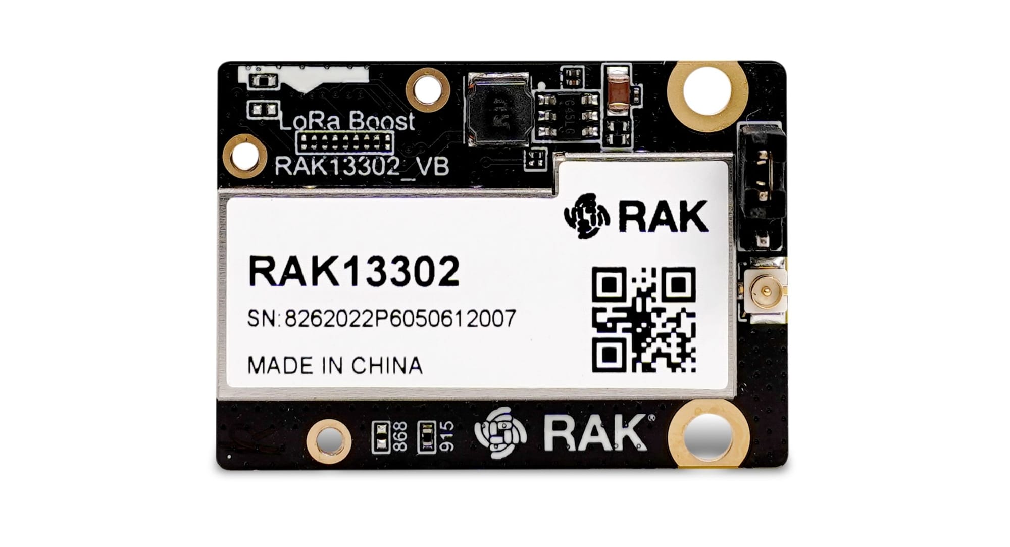

Why This Matters for Meshtastic Users
Meshtastic depends on reliable two-way communication, not just long transmit range. A radio must hear weak signals as well as it can send strong ones, or the mesh becomes unstable and inconsistent. A properly engineered 1 watt design, like the RAK13302, strengthens both sides of the link, resulting in fewer dropped packets, more dependable backbone nodes, and better performance in real-world terrain and noise. In short, balanced RF performance creates a stronger and more resilient community mesh.
RAK13302 module representing a balanced 1-watt design that improves two-way reliability and strengthens Meshtastic mesh performance.

At the heart of the design is a carefully sequenced RF chain:
SX1262 → SAW Filter → SKY66122 (LNA/PA) → SAW Filter → Antenna
Each block plays a specific role, and the order is intentional.
This is how the system achieves stable 1-watt output without degrading sensitivity.
1. A Receive Chain That’s Stronger Than Stock LoRa
Most high-power DIY boosters reduce sensitivity. RAK’s design increases it.
  • Baseline SX1262 sensitivity: −137 dBm
  • RAK13302 optimized sensitivity: −142 dBm
That ≈ 5 dB gain translates into noticeably longer and more reliable links, especially in forests, cities, and hills where signals arrive weakened.
The improvement comes from two engineered components:
  • A high-performance LNA inside the SKY66122 (+11–13 dB gain)
  • A 915 MHz SAW filter that prevents overload and rejection issues
Together, they boost weak signals cleanly without adding noise.
2. A Clean, Stable, Legitimate 1-Watt Transmit Path
The PA inside the SKY66122 delivers:
  • 30 dBm (1 W) output
  • Low distortion, preserving LoRa’s modulation
  • Excellent harmonic suppression when paired with RAK’s SAW filter (−45 to −52 dBc)
This isn’t just “more power.” It’s clean, regulation-compliant power that won’t pollute nearby channels or deafen your own receiver.
