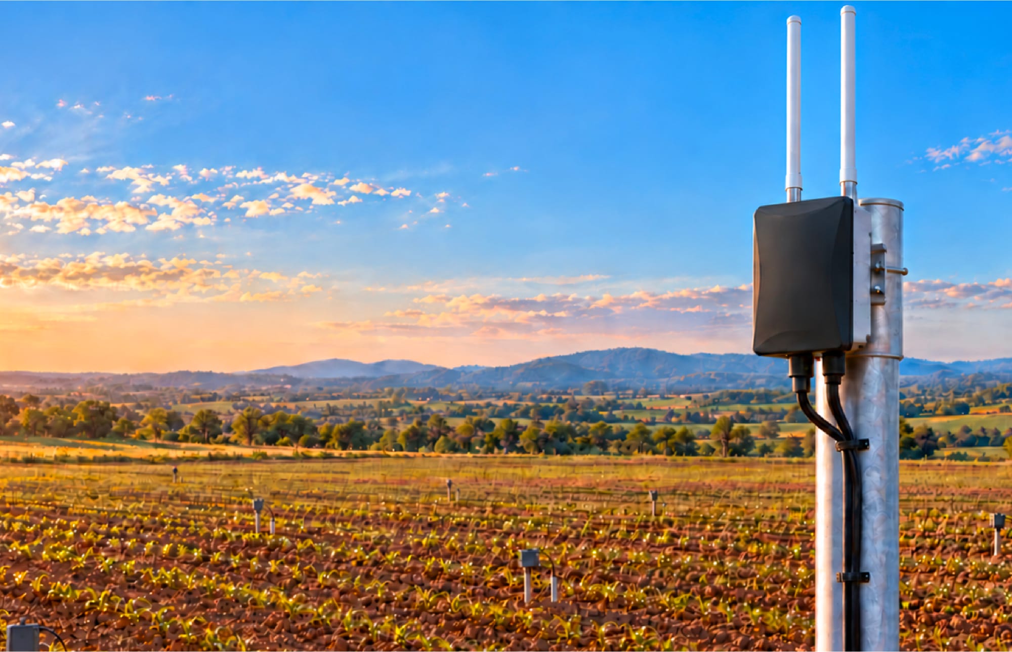

Three hundred soil moisture probes across forty square kilometres of farmland. None near a power outlet. Nobody is driving out to swap batteries, because at that count it becomes a full-time job. WiFi dies at the edge of the first field, and a SIM in every probe would cost more than the probes did. That combination is ordinary in agriculture, utilities and industry, and it is what LoRaWAN was built for: a few dozen bytes, a few times a day, over kilometres, on batteries that last years. So what is LoRaWAN, and when is it the right choice?
A field of RAKwireless Sensor Hub soil monitors staked across bare farmland, each with a stainless steel probe buried in the soil, illustrating low-power end devices for LoRaWAN®.

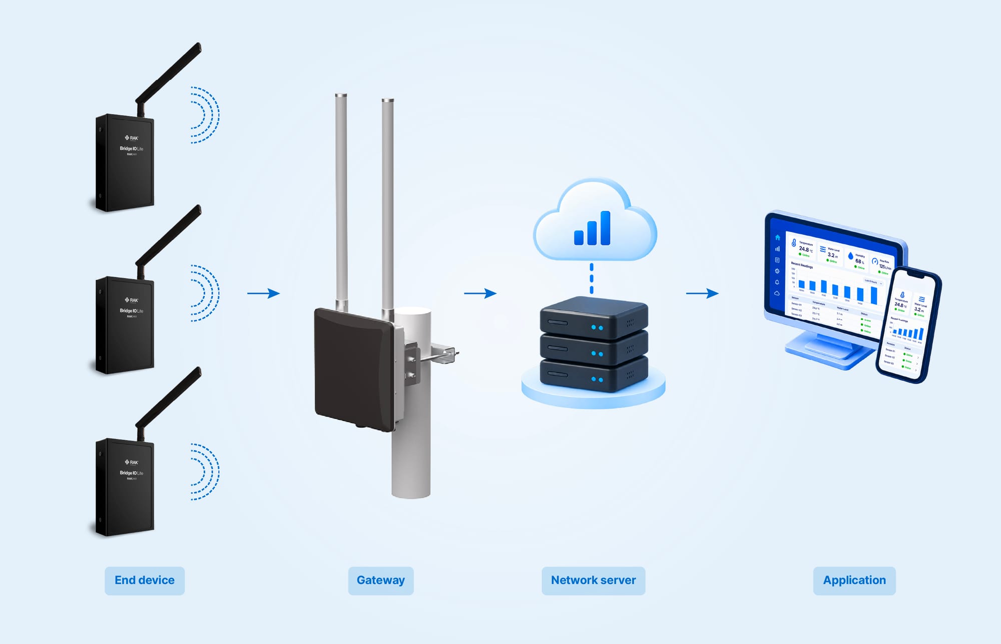

How Does LoRaWAN Work? The Four Parts
Answering what is LoRaWAN in practical terms means looking at four pieces. Every LoRaWAN network, from a single building to a national deployment, is built from the same ones.
1. The end device
The end device is the sensor or actuator in the field, usually a microcontroller paired with a LoRa transceiver on one stamp-sized module. RAK's WisDuo modules run from 1.8 to 3.6 volts, low enough to sit directly on a small battery, and hold their configuration in flash, so settings survive a reboot, a power cycle, and a firmware update.
Devices come in three classes, and the choice sets battery life.
Class
Listening behaviour
Battery life
Typical use
A
Brief windows after transmitting
Longest
Battery sensors on a schedule
B
Adds scheduled receive windows
Moderate
Predictable downlink timing
C
Listens continuously
Shortest
Mains-powered actuators, fast response
2. The gateway
A gateway is the antenna-equipped box that hears whatever devices are transmitting nearby and passes their packets onward. It does not interpret your data. It is a bridge between the radio world and the internet.
Not all gateways listen the same way. A half-duplex unit transmits or receives, never both at once. Full-duplex models do both, which cuts latency on busy networks. They also differ in backhaul, the internet connection reaching the server. Multi-backhaul models let you set Ethernet as primary with WiFi or cellular as automatic fallback, returning to primary on recovery, so a cut cable does not mean lost data.
Diagram of a LoRaWAN network showing sensors transmitting to a gateway, the gateway connecting over Ethernet or cellular to a network server, and the server passing data to a cloud application.
3. The network server
The network server is the brain. It deduplicates packets when several gateways hear the same device, checks security, manages join requests, adapts data rates, and decides which gateway sends any reply. Gateways reach it in one of three modes: Basic Station, Packet Forwarder, or a network server hosted on the gateway itself. That last option matters for small deployments, letting you run a complete network without a third-party subscription.
4. The application
The application is where data finally becomes useful. A dashboard, a maintenance ticket, a row in a database. It receives decoded payloads from the network server, usually over MQTT or a webhook.

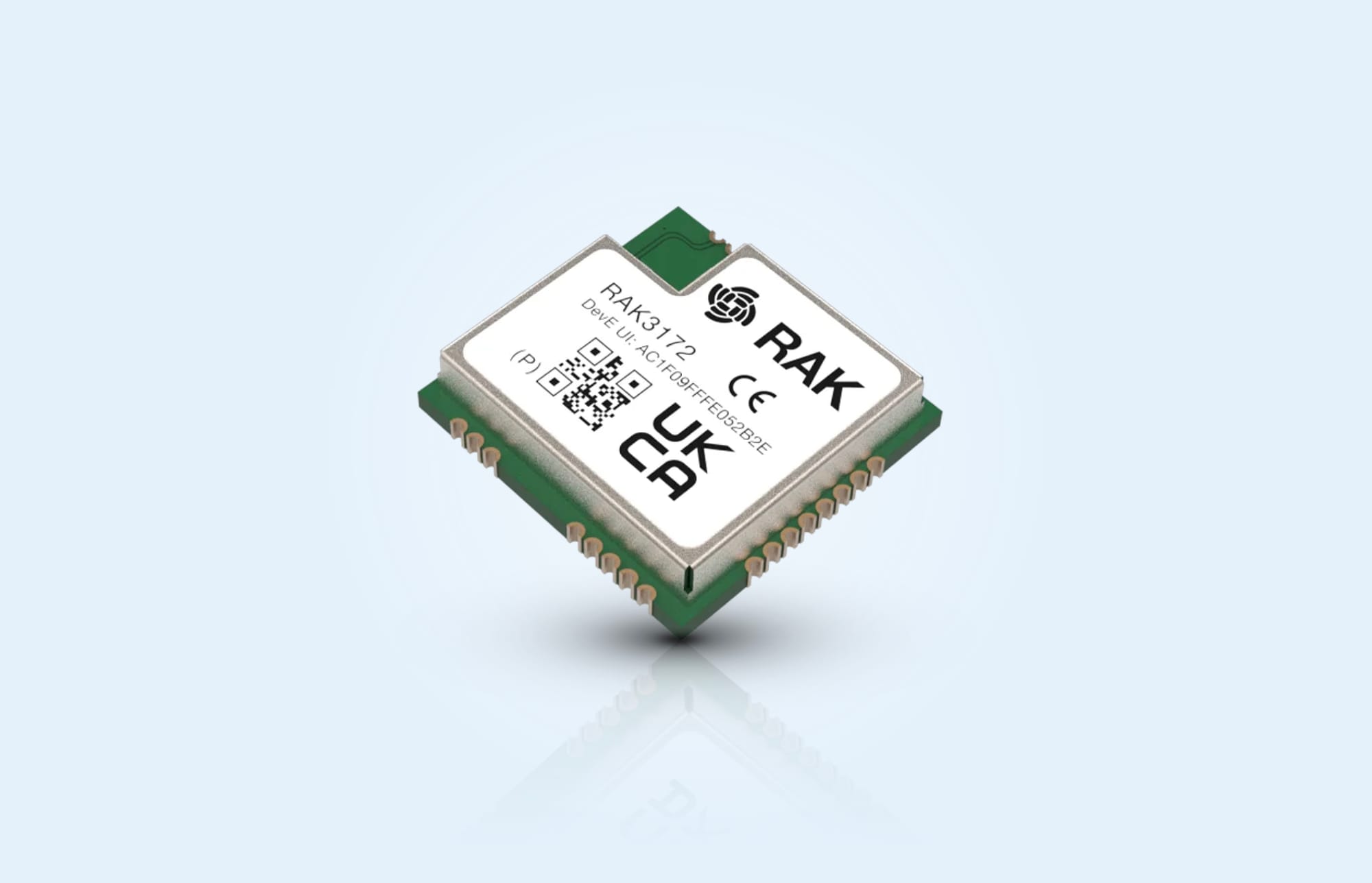

The device side is where teams over-engineer. A module containing both the microcontroller and the radio removes most of the RF work, and integration can be as simple as power, ground, and a serial connection to a host controller. Open-source firmware frameworks such as RUI3 handle the LoRaWAN stack, so your engineers write sensor logic instead of protocol code.
If you are scoping hardware, start with RAK's WisGate Edge gateways and the WisDuo module range, and read Things to Consider When Picking a LoRaWAN Gateway before committing. For the specification itself, the LoRa Alliance maintains the standard.
The RAK3172 WisDuo module, a stamp-sized LoRaWAN module combining an STM32WLE5 microcontroller and a LoRa radio in a single component.
